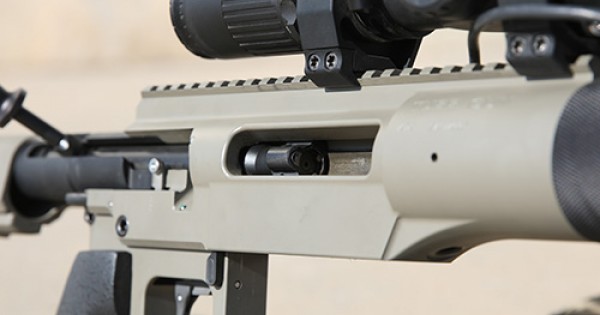

It is David Tubbs Adaptive Target Rifle barrel. The barrels he sells are not blanks but prefits for that platform.

Other than the cool name there is also 11 High Power Rifle National Championships, 20 Silhouette National Championships, and six National Long-Range High Power Championships. Some in these shooting disciplines also consider the T-2K to be a somewhat groundbreaking rifle. Tends to make the marketing carry a bit more weight.

If you have not handled, shot, or seen one in person you are speaking from a position of ignorance. Before making grand sweeping statements you should do a little homework. The rifle is out of my reach but I have shot several of them at matches. There are indeed many things about the ATR that sets it above and apart from the generally accepted standard rifle.
