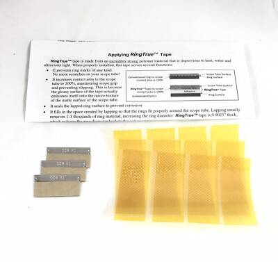

I believe I had read in a post about putting electrical tape on the rings ? Can anyone confirm this ?
I use painters tape on my rings and eliminate marks on scopes. I have also used Burris rings with inserts which also eliminate marks. If you already have rings that you like, use tape.

The biggest cause by far is guys over tightening the rings. I can't understand someone paying $500+ for a scope but too cheap to use a torque wrench to properly tighten the rings. If you want to do it right, use the alignment bars to ensure concentric alignment, then bed the scope in the rings (or use a little tape), tighten only to recommended torque, and I guarantee you won't have marks on the scope.
