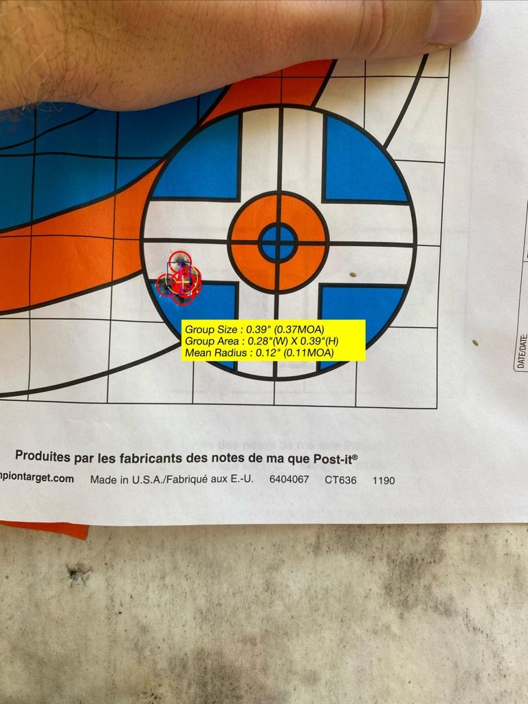

I swabbed the chamber with alcohol and reran the two top charges, still got marks, but a lower velocity. I loaded 38.1 gr which seemed like a good flat velocity node, and shot a .293” group at 100 yds with ease, at 2803 fps average. That will work for deer season this year, but will continue to tinker further in the spring.
