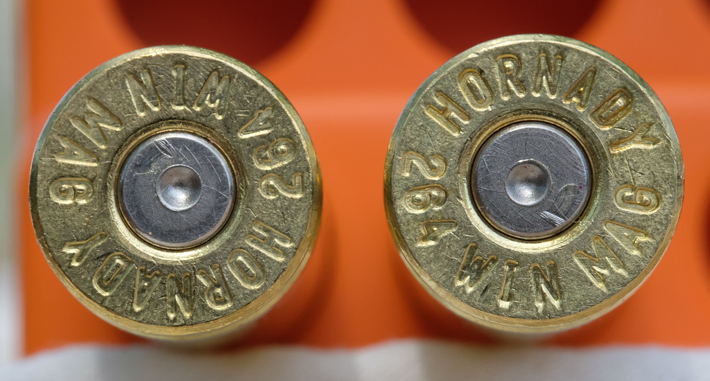

Below are a couple of examples. Velocity of the left case was 3359, velocity of the right case was 3497. I am interested in understanding the general principles of reading primers and cases for pressure signs.
If your firing pin hole is sized correctly it’s hard to see cratering(primer flow). To me the better indicator is how flat the primer is, squared edges. Plus look for case head smearing. If you get any of the pressure signs, sticky bolt lift, excessive primer flattening or has head smearing it’s a good idea to re evaluate.
Though if your firing pin hole is a bit over sized it will be easy to see cratering as the primer will try to flow back into that hole.

I can't really tell but it almost looks like an ejector mark over the "G" on the left case and another between the G and Y for the case on the right. Is the ejector on this gun square by chance? If so, then I'd say those are ejector swipes and you are a bit over max.

Youre not over pressure but you could be real quick this summer. Get a loupe or magnifying glass and look for the ejector

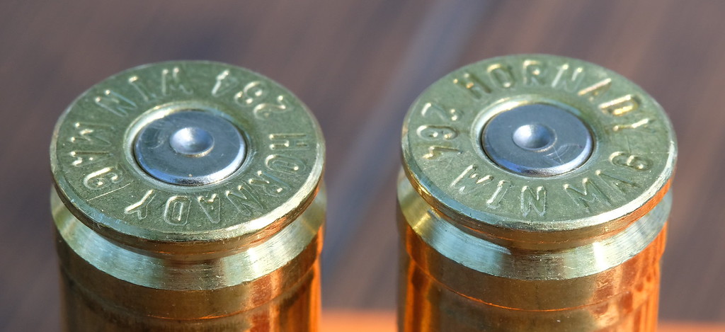

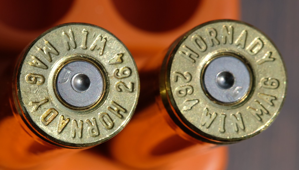

Thanks for all the great feedback. Lots of details for me to learn about this pressure stuff. Based on the feedback, I added a few more photos.
I agree with B23 that I think I see square ejector marks in the first photo. But, they sure are hard to see in real life and in these other photos.

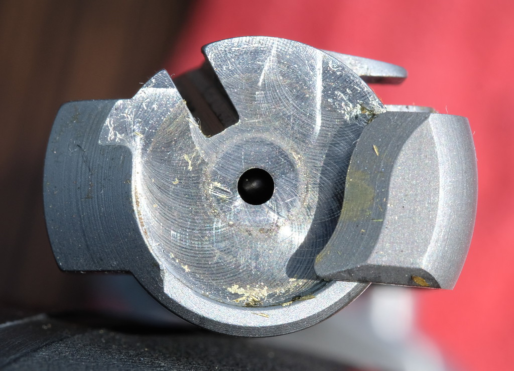

And, the close-up of the bolt face shows a small machining "gouge" which appears to correspond to the swipe marks on the primer. In fact, in addition to the wipe mark, the primer is picking up an exact impression of the gouge. Which I guess is an example of primer marks being caused by bolt's physical characteristics/idiosyncrasies rather than caused by over pressure.

I see a small gouge near the firing pin hole that is engraving into the primer during ignition. A piece of self adhesive 320 grit sandpaper stuck to the head of a spent case, chucked in a drill will work to polish out that defect.
I don't see brass flowing into that big ol' ejector slot, so your load isn't completely over the top. But the primers are flattened and therefore you are near or at max safe load in YOUR chamber. No one else's chamber matters, just yours.
