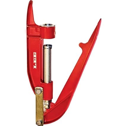

I currently use a Rockchucker but I am partial to Lees, I have had three and still have a Lee O style set up as range press and a Lee hand press also for the range. If I had to choose between an expensive press and inexpensive dies or inexpensive press and expensive dies I would go with the dies. That's what provides the precision, the press just supplies the muscle to get the case to the die.

If you size machine gun fired Lake City 7.62 brass using the Lee hand press you will look like below or else die of a heart attack.
You have be given many serious ideas in this posting, but if you want to go from a A cup to a D cup try the Lee hand press.:D
