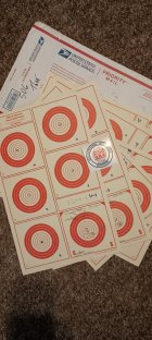

I've wondered this as well. Just last weekend I was able to give it a test with a 30br that I had brass prepped for thats been settng for about 3 months. I wanted to do a seating test on a new lot of bullets and the brass didn't seem to have any difference then brass I had just prepped and accuracy was great. After a seating depth test I shot this target just to verify it was good to go.

I've wondered this as well. Just last weekend I was able to give it a test with a 30br that I had brass prepped for thats been setting for about 3 months. I wanted to do a setting test on a new lot of bullets and the brass didn't seem to have any difference then brass I had just prepped and accuracy was great. After a seating depth test I shot this target just to verify it was good to go.
If I shot that target in a match with MY 30BR, I would lose!
Ya completly missed that top left bull!!
