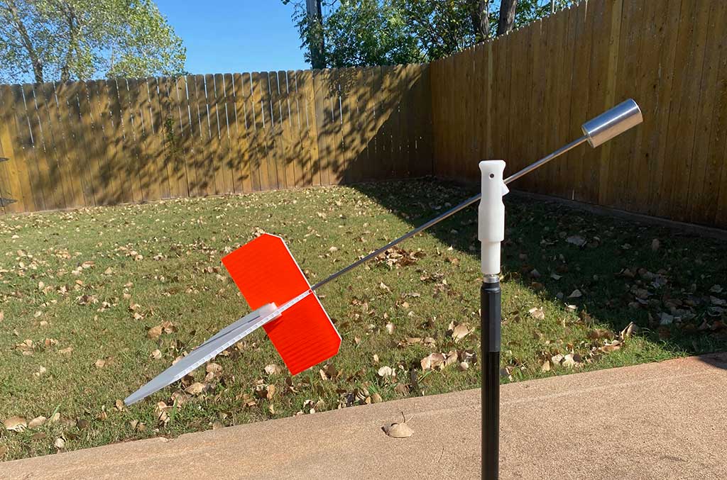

At our club we have a "covered" firing line, a roof. But because of our snow conditions, the roof is peaked and we believe that the peak acts similarly to an airplane wing. The result being that if the wind switches to coming from behind the line, we get all kinds of weird vertical and there is no way to identify it, at least not that any of us have been able to come up with.
My range has a similar roof. I see strange things happen when we get a south wind. Luckily the most common winds are SW to NW.
This might be a solution.
We have pillars to support the roof and some of the benches are next to them so if you end up on one of them benches it gets interesting as I believe the wind can swirl around it and cause some issues! add in berms in between it gets really interesting sometimes.
The link from those flags…
