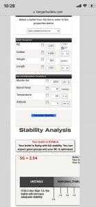

It’s a 1:10 twist, 6 groove Krieger. I did the rod spin test on it. This barrel sat as a blank for a long time and I couldn’t recall for certain.
it appears you have PLENTY of stability with the 500 grain a tips
Yeah, many years back, probably about 7, I was perusing the Krieger inventory list online. I saw that barrel and thought, I have no real need for that, but I bet they had a cancellation, and how often will something like this be available. I knew this would sit idle with me, and thought, if I was supposed to be the buyer, then they’d accept $500 for it, and I called them. I know I was only drawn to it for the ability to stabilize anything out there. My smith of told me on this one he didn’t cut off the button for me to save, as is my habit. I smiled. It was a lot of cutting, I know, but if he wanted a 2 inch button for a keepsake I’m more than fine with that anyhow, but that’s why I couldn’t lay hands on the twist rate.
