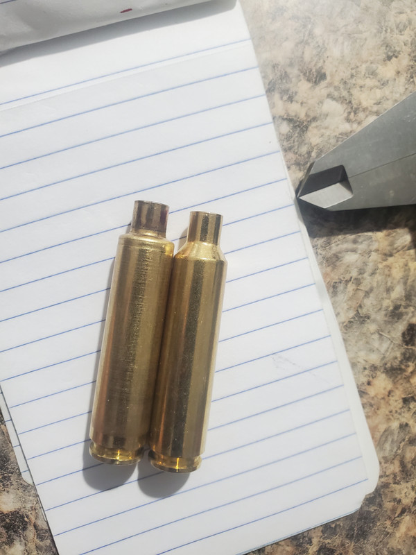

Here's a fun one, I picked this rifle up as an unfinished "gunsmith" project. I was told it was 6.5x284. I fired a round and thought it may be an AI.....then I picked up the brass and realized that someone sunk the drill too deep before boring.
Super duper ackley ultra improved.
Even without the drill work, that's not a pretty chamber. I did something similar once but caught it when I tested the rifle. I bought a new barrel on that one.
