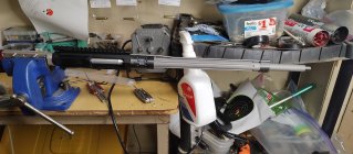

So just some updates. Got all my build parts in for my upper . This is just a play around caliber so everything with either NBS ,on sale or just chicom. Not halo jumping with this thing strapped to my side , shooting 400rd in a fire fight or dragging it though the mud on some navy seal stuff so I really don't need all the hyper tough milspec stuff. Gonna be popping steel, crows and the occasional Varmint with this thing. And this is supposed to be something for the budget guy who wants a .17cal centerfire without the crazy cost of entry of alot of legacy cartridges.
Anyhow went together pretty easy and just going to use the bolt carrier group out of my .223 Wylde SPR for now
Will say though the 17" hand gaurd looks a little goofy on a 18" barrel but my preferred was out of stock and it was the only one left in my price range that was too short.

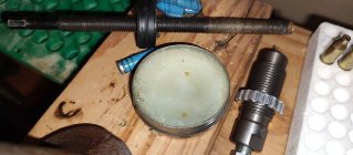

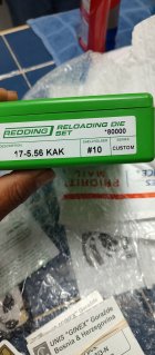

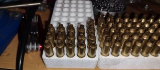

Then my dies cam in tonight. Very first set of Redding dies and super impressed with the quality . No shell holder though

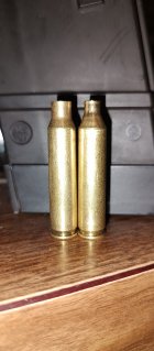

So according to KAK'S VERY OWN VIDEOS all you really do is make sure your brass is once fired so it's work hardened then run it up in the resizing die....and that's it. No neck turning or step dies lube and run.

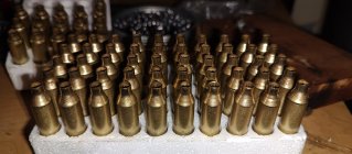

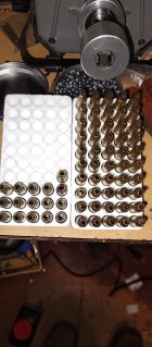

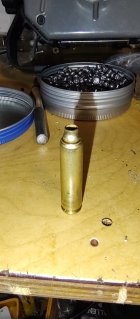

So got some of my my lake city once fired lubed it up with that good ole imperial and well,
IMG_20240113_003238623.jpgIMG_20240113_003312449.jpgIMG_20240113_003351655.jpgIMG_20240113_003543119.jpgIMG_20240113_003644603.jpg

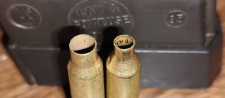

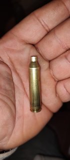

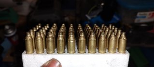

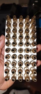

Now I e been seeing people over in discord talking about getting a 10-25% reject rate due to crushed necks and yeah seems about right. Would get 5-10 good ones the 3 or so crushes and so one. Seems the main problem is just going to fast into the die
But can always chop it for .300 blk or similar. Anyhow 15mi. Got me 50 PC of decent looking brass and few rejectsIMG_20240113_010452697.jpgIMG_20240113_010507076.jpgIMG_20240113_010528323.jpgIMG_20240113_010541781.jpgIMG_20240113_010553415.jpg
That's quite the neck-down step! If you had a 223 bushing die, it would probably be a higher success rate if you stepped it down in stages. I do that with my 20 Practical. First stage in my 20P process is just size the cases with a FL RCBS sizing die with the expander ball removed. That necks it down quite a bit, then I do two more bushings from there to get to 20 cal. Do you by chance have a 223 Bushing die? If nothing else, try sizing with a full length 223 die first with the expander removed, no need to buy any new die that way.

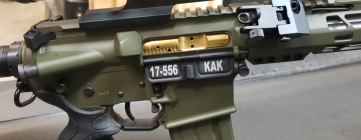

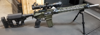

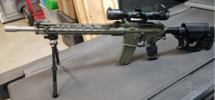

This is my 17-556 KAK, using an 80% lower which I did on a Grizzly mill. Fluted 18" KAK barrel. I went with only Lake City brass and the Redding 20 Practical followed by the 17-556 sizer die. I had some trouble with the sizer die AND the barrel, but all OK now. KAK had to hone the chamber. I have shot about 500 rounds. Some of the cases have been reloaded 5 times.
17-5.56 KAK 1:9 Twist .17 cal in a 5.56 case with a resized neck. RCBS Shell Holder #10
Brass: Lake City 5.56 brass ONLY! Trim Length: 1.750”
Directions: First time - Use a Redding sizing die for 20 Practical to bring the neck down from 5.56 to .20. THEN use the Redding 17-556 sizing die. Doing it any other way will ruin the shoulder, and will jam in the rifle chamber.
Primer: CCI BR-4 Bench Rest Primers
Projectile: Hornady 15.5 gr NTX #17016
Powder: CFE 223 27.0 gr. (25.0-28.0 gr.) Velocity: 4225 fps.
OAL: 2.152” Lite Crimp using Lee Factory Crimp Die
Projectile: Hornady 20gr VMax #21710
Powder: CFE 223 26.3 gr. (25.8-26.3 gr.) Velocity: 3895 fps. SD-31
OAL: 2.169” Lite Crimp using Lee Factory Crimp Die
Projectile: Hornady 25gr VMax #17105
Powder: CFE 223 25.5 gr. (25.0-27.0 gr.) Velocity: 3797 fps. SD 14.3
25 yards - 10 rounds of 25gr Hornady V-MAX using 25.5 gr of CFE 223. I got a little sloppy at the end, aiming at a hole...
