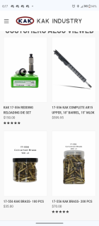

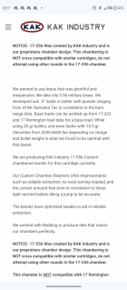

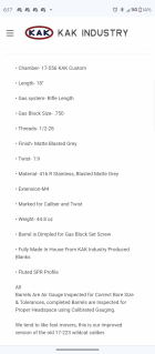

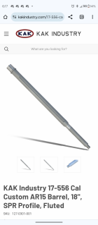

So I've been pretty bummed trying to figure out how I could go about having a low cost .17cal center fire. Wanted to build my own on an AR platform but custom barrels,brass and and other stuff have been getting irritated. Well like my prayers where answer this just popped up on my 50th something search I know these guys make some nice off the wall AR stuff like a 300wsm upper and this looks like it might be the answers to my prayers !!
