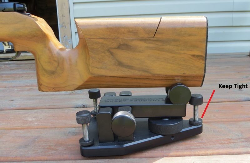

When I was considering going to a mechanical rear rest (right before Dan/PQP started making under the PQP name) I asked Stiller about the Holeshot version at one of our matches. He said he liked how a rear bag (like I was using) dampened vibrations and that it would be hard to improve how I was shooting (why change?). About a year later, out of curiosity I ended up ordering a PQP rear from Dan. It's a really nice piece of equipment but I don't think it changed my scores any. I do like how it makes it easier to traverse the target when shooting from a bipod. Last time I used it I noticed the horizontal adjustment was causing it to track across the target funny. Target was level, bench is level, and the rest was level. Not sure what was going on there. Since then I've had two other ARA factory class shooters tell me they stopped using theirs for the same reason. I still haven't taken the time to really look at mine and see what the issue is. I still like mine and plan on using it for casual shooting. If I was to do it all over again I probably wouldn't spend the money on one

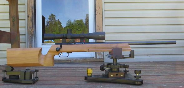

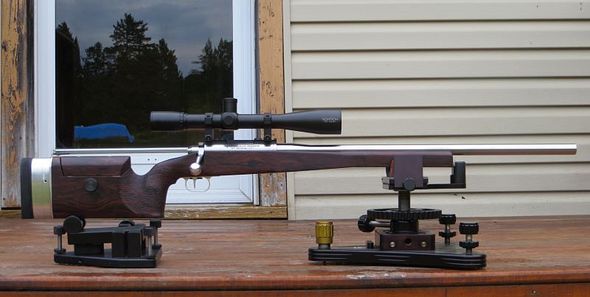

I have a PQP mechanical rear rest and I use it with rifles with stocks that are inline, with no cast off. It works well.

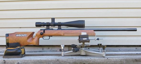

I have a good shooting rifle with a BR-style stock that has cast off (it's designed so that it can be held when if the shooter desires). I use a Protektor rear bag with it. It shoots as well as the other rifles. It is shown at bottom with a front rest no longer in use.
In my experience neither rear rest deters good results.

I noticed that previously but I don't think that's the issue I was seeing. IIRC I was seeing the elevation rise a little. I even started holding the elevation wheel just in case that was moving when it was supposed to.
I don't necessarily like that there's lettering where the "ball" rides but it hasn't caused a problem for me. While I was thinking about it, I decided to get my PQP rest out and take a look. Everything seems to work well. So leveled the rest and set a small Mitutoyo gauge block on top and then set a dial indicator on it. The needle on the indicator didn't budge as I adjusted the windage right and left. So I'm not sure what my issue was that day. The rest seems fine. The needle didn't dance around at all. Which leads me to believe that the lettering isn't an issue on my rest

I found that when using in conjunction with a locked down front rest it would try to tip on its side when getting near the horizontal edges of a card. That wasn’t an issue when the front was looser or when using a bipod.
