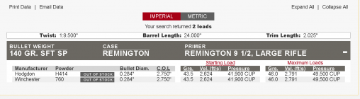

Thanks guys. Maybe I should have started with this. - I have been reloading for many years and have never use "equivalent" powders but times are tough here in Alaska. Looking at http://www.adiworldclass.com.au/powder-equivalents/ it appears I could START with minimum loads and work up. I have a 6.8 Western and load data is hard to find right now and powders up here in the north is hard also. I've got a little IMR4350 and a new can of W760. Wanted a second opinion.

I looked at Hogdgon reloading data site they specified 9 1/2 primers but not the 9 1/2 M. I may have to try 760 with magnums and see what the difference is.
Regular 9 1/2s are pretty hot as it. Wouldn't surprise me if that was the recommendation vs a magnum.

It appears that the IMR 4350 match with W760 is still a question. I'll call Hogdon and Sierra and let everyone know what they say. Thanks for your input.
