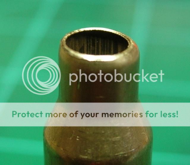

As a matter of fact, this just started happening. I've sized/trimmed all my brass so that's not the case so it must be something in the powder drop. I'm going to take it apart and give it a good cleaning. It has never done this before. Oh, I might mention that it doesn't get that resistance when it's all the up, it will start to catch about midway up into the powder drop. Also I was thinking maybe the powder is jamming up the drop tube since it's IMR 4064.
Here's a pic of the case neck showing how it's getting smashed.
Just a quick update, I think it's the 4064 powder jamming up the drop tube. I tested about 20 cases with no powder and there was no sticking problem at all. Put some ball powder and tried it again and no problems. Maybe I'll just have to hand load the 4064.

Just talked to Hornady and sure enough it is the 4064 powder causing the problem. They do sell a Extruded Powder Sleeve part #392699 that will keep it from damaging the case but you will still have it snag on the powder sometimes.
