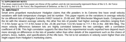

Even H4831 can have a spread of about 10% between lots.
https://apps.dtic.mil/sti/citations/ADA572333. -

Case in point as posted above, 4831 is not a bulk grade powder, it is supposed to be "the same" every batch and here is the abstract from the paper that was linked by @243winxb .
When you care about performance out past 300 yards, you have to test lot variations of all sorts, not just the powders. Trust only the target to tell you if the powder is really "identical" in a new "batch" or "lot". Now that chronographs are falling off of trees, this should all be common knowledge.
