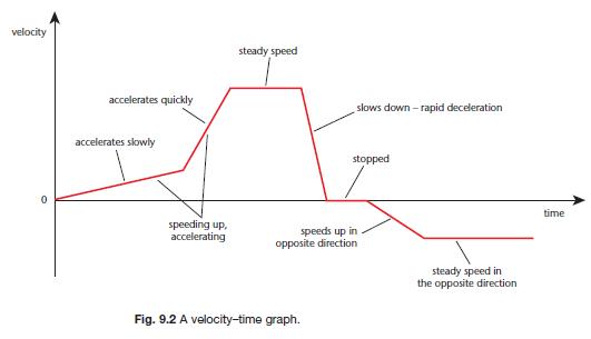

OK. the impact of the rifle with your shoulder is the result of the the rifles velocity at the moment it strikes the shoulder. What drives that rifle velocity is the Weight of the projectile and the rate it is Accelerating. You are confusing the forces that create the momentum required and what changes it. Velocity is nothing more than a snapshot in time, where acceleration is how you measure the the characteristics of what caused the end result...Velocity.
You can go 100 miles per hour and there is no G forces present. It's how fast you achieved 0-100 mph that demonstrates the difference from one acceleration curve to the next. The amount of time the bullet spends traveling down the tube is the primary force that creates recoil, which is the result caused by the momentum of the rifle. Measuring velocity only tells you how hard the bullet would impact the target if it were to hit the target at that precise moment.
The affects of recoil on a person are caused by many things, not just the momentum of the rifle. the torque, the muzzle blast the characteristics of the gun itself, the design of the stock. These are all vectors responsible for your perception of recoils affect on your body. All of which cannot be measured, only the person firing the firearm can determine it's amount of pain. Cartridge design and powder improvements have allowed man to alter those vectors which raise or lower ones perception of the intensity of recoil.

We are as we speak traveling at a velocity somewhere between 800-1200 mph. Do you feel any effects from that velocity?
Your reference of using a hydraulic cylinder to launch a rifle will in fact be variable, dependent on the acceleration of the forces from the hydraulic cylinder. The speed and the intensity is infinitely variable.
You see this displayed at drag races where a vehicle will travel the 1000 ft quicker but at a slower terminal velocity.

Remember that kinetic energy is not acceleration.
KE = 1/2 mass x the velocity squared.
Notice that there is no time involved in energy so energy only cares about mass and velocity.
Acceleration is a rate of change of velocity with respect to time but energy is not dependent on time or acceleration.

The area under the time pressure curve is the energy that causes the rifle to recoil. That is a closed system until the bullet exits the muzzle..
According to your notion a load using using Unique to produce 1300 fps would have more recoil than the same velocity produced by 4198. I can tell you that it doesn't. Even though the Unique accelerates faster the muzzle velocity is the same.
You are still wrong and always will be until you figure out energy.
