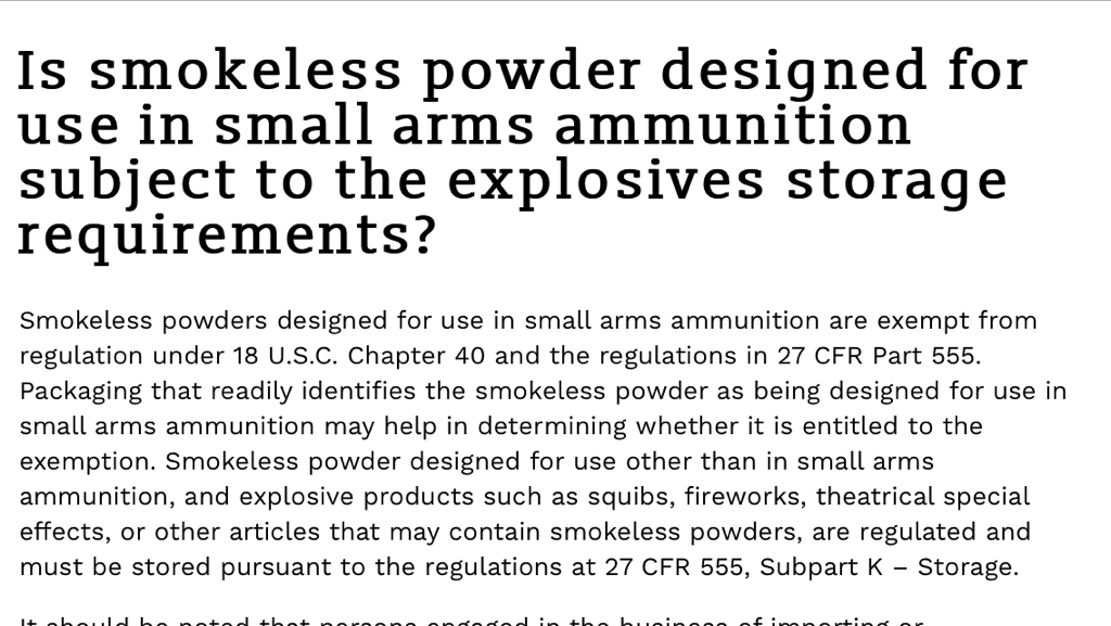

Not sure I think you need a permit from ATF if you have over a certain amount of powder. Some state fire codes require approved fire resistant containers if you have more than a certain amount. Good luck. Happy shooting.:)
I'm good. Had this conversation with ATF field agent.
