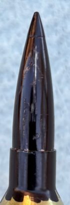

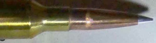

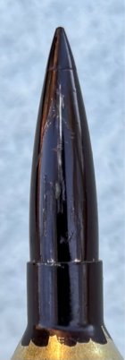

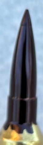

Good afternoon,
I have a Ruger American Predator Gen 2 in 6 arc.
About three weeks ago after hunting I removed the chambered round - bullet stuck and powder everywhere.
Once fired Starline brass, full length sized, neck turn mandrel to expand and brass was annealed. The COAL for that hunting round using Sierra 85 gr bthp GameKing was under recommended coal.
I cleaned it well after. However, every round I chamber in the rifle comes out with marks on the bullets. My hand loads and factory Hornady 108 eld and factory Hornady 105 black.
My guess short throat. The 108s come out with rifling marks on the bullet- or did.
Attached is a pic. Now, marks only on one side of the bullet. I don’t have a bore scope nor do I know how to measure if the chamber is cut correctly.
Just trying to determine do I remedy or send back to Ruger. Thanks in advance.

Make yourself a split neck case using a Dremel cutoff wheel. Cut it lengthwise and down into the shoulder. Put a bullet in and chamber it. Unchamber then measure using an ogive gauge from Sinclair. That's your seating depth to the bullet touch point. Very simple.

I appreciate the tips so far, but my COAL with the 85 gr Sierra is 2.104 and my BTO is 1.739
Way under spec and I’m seeing marks on the bullet which is why I think it has a very short throat.
Have you fired the rifle much at all or is this a relatively new purchase?
The reason I'm asking is I have encountered rapid carbon build up/carbon ring with some powders. Varget in particular tends to do this in my personal experience. Also, based on your first post, it seems the problem improved at least some when you cleaned it.
I also suspect you might have a carbon ring in the freebore area or lead. If so, you will need to clean the lead aggressively with solvent/brush and/or JB/Isso. Carbon rings in the lead aren't likely to respond to normal cleaning regiments.
If the above is accurate for your chamber, you would definitely be jamming the bullet at a CBTO of 1.739 in a fresh chamber. My guess is touch would be around 1.670 in a new chamber. Unless you have around 70 thousandths of throat erosion, you are jamming the bullet based on the above.
If the above is accurate for your chamber, you would definitely be jamming the bullet at a CBTO of 1.739 in a fresh chamber. My guess is touch in a fresh chamber would be around 1.670 in a new chamber. Unless you have around 70 thousandths of throat erosion, you are jamming the bullet based on the above.
With this much jam on a new chamber especially, it would be enough to pull a bullet from an unfired load.
