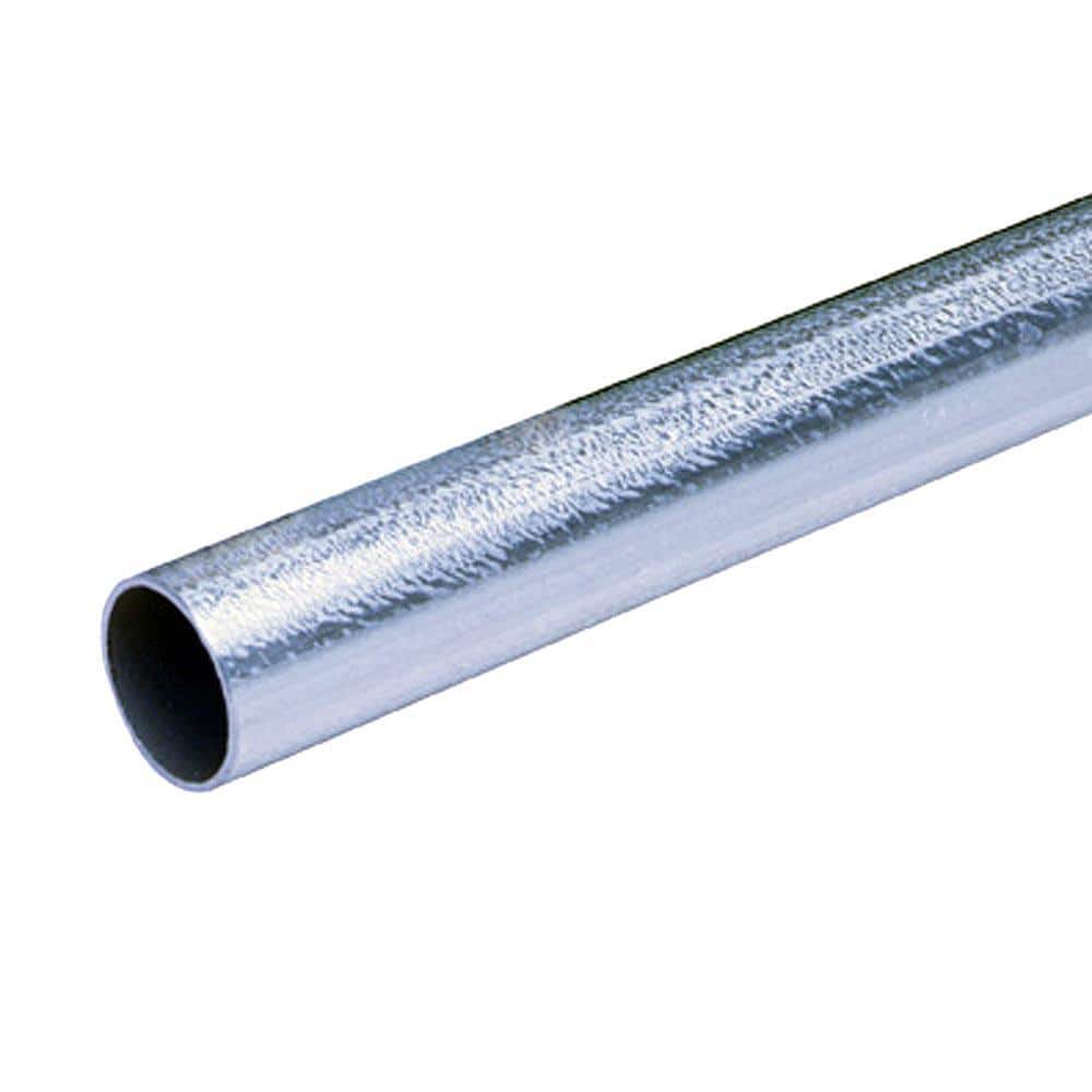

I think I might consider on the next one to use electrical conduit instead of black pipe I think it would work just the same and it would probably cut out 20 lb
Are you talking EMT?
