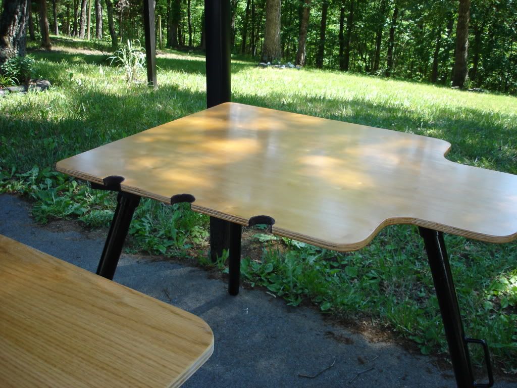

This bench has 1.25" diameter pipe screwed into pipe flanges using wood wedges to make the legs angled.

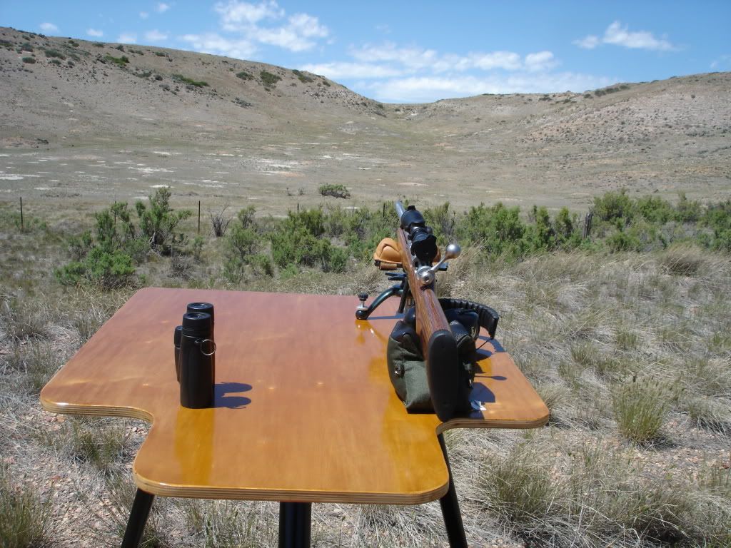

This bench has 1" diameter legs welded to steel plates like DogBuster mentioned. The legs don't unscrew like the other bench. I prefer this bench. I currently have both and my "guests" get to use the first bench pictured.

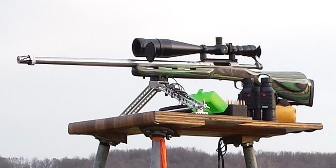

This is my used & abused portable table...lives in the bed of my Tacoma all summer...probably has 50K + rds shot from it...don't leave home without it.......... :D
20BR perched on top...which is now rechambered to 20-222 (9 twist)

I have a set of brackets like that, with the pipe legs etc. with two layers of 3/4" plywood for the top.
I like everything about mine except for the shape that I cut the top into. I cut too long of a notch into the left rear corner of it.
I need to determine a better top shape for mine, otherwise it is a really solid nice shooting table.

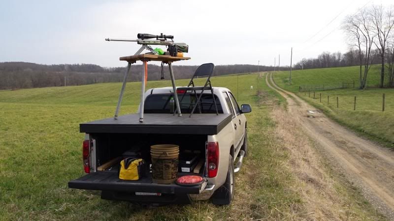

My bench tops are now simple rectangles. I position the rear bag at the edge of the bench and the stock overhangs 3 to 4 inches. This makes you shoot square to the rifle which I'm told is a good thing.
With my bench sitting on top of my shooting deck which is on top of the bed of my Chevy Colorado and shooting at groundhogs, I sometimes need to swing the rifle to the back left or right corner of the bench. With the top being a rectangle, this gives me the maximum amount of versatility.

Simple. Raise or lower the bipod if the slope is up/down. If sideways, adjust the cant on the bipod.
When I hunt groundhogs, I frequently have to park the pickup on some sort of slope. But even leveling the bench on uneven ground wouldn't work if you're swinging the bench around to make shots. Trust me, unless you want to spend considerably more than $100, my bench works quite well.
I have been in fields where I literally have groundhogs all around me, necessitating spinning the bench 360 degrees. I just pivot it on the rear leg. Of course, I have to scoot the chair around as well. Shooting from the deck on the bed of my pickup allows me to shoot in all directions by just pivoting the bench.
