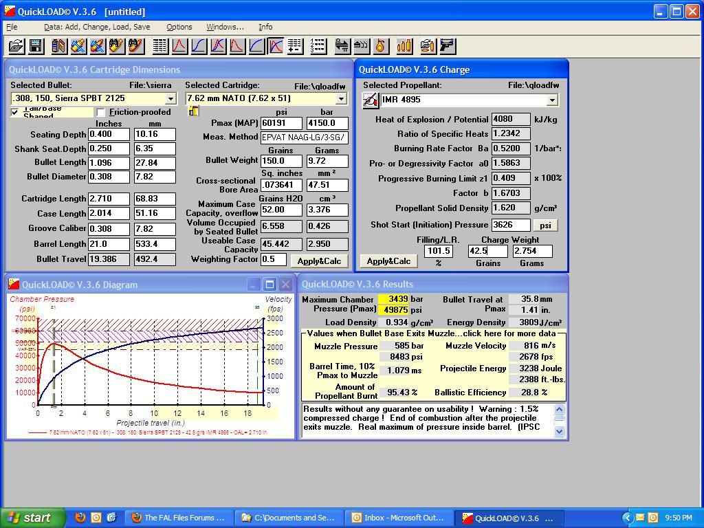

I was wondering about the same thing as you and Quickload port pressure to find a ball powder to work with on my XL650. But running different powders in QL showed little difference in port pressure to make a educated guess.
According to QL I should be able to use every powder from H335 up h414 and everything in between. But in reality I know this is not the case, so I will have to try different ball powders to see what works best.
In QL I was looking for port pressure around 12,500 psi around the 15" area.
