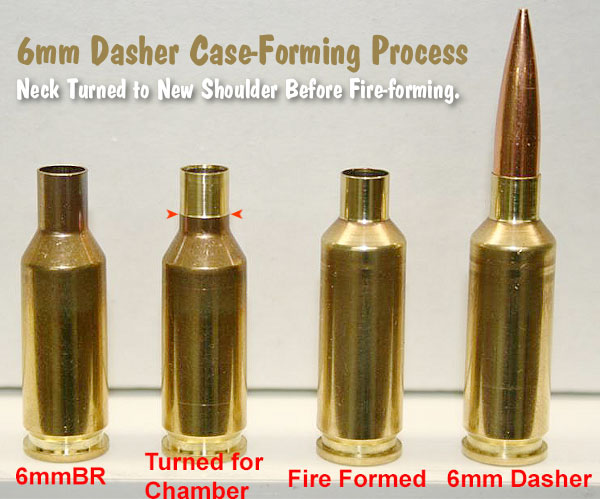

Re-read the 6dasher forming article, will go with the false shoulder. Whats everyone using to expand?
I have a K&M, would just need to order the .257. The article mentions the hordany, but not finding anything on it, like what die
Full length size the BR brass making sure the neck is sized past where I will neck turn.
K&M Expander then neck turn past the future neck/shoulder junction.
expand to 6.5 (Used to use a a 25 cal expander but if neck turning first the .25 cal false shoulder isn't enough)

I run a .264" neck and this is how I do it...
