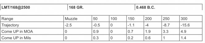

Here's some JBM calculations for a 220gr, 486G1 308 with a muzzle velocity of 2800fps.
Bore centerline no sight height, 1.5" sight height, and 2.5" sight height.
Sight-Height-and-Zero-Range.jpgWhat about longer ranges? Same Bullet/Speed.
MOA this time.
