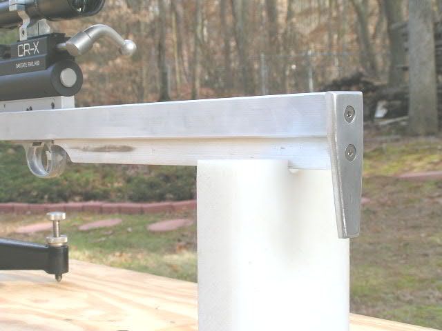

i currently use a 3'x6'x 0.5' al plate on my fore arms....

How about some further info on the front 'flat' you are using on your forearm? Does it attach to the sling stud? Did you make it yourself etc?

i have two flats,getting a third made). they have a channel cut down the center, just a tad larger than the free float tube, and then are glued and screwed to the tube. originally on an ar10t i just screwed to the swivel stud hole.

Am a big fan of the PRS stock. I'm also thinking of getting the EGW rear bagrider for my other lower with an A2 stock, and a front bagrider from either Sinclair or EGW.

I've found a Magpul PRS buttstock excellent and it rides a bag well. Up front, I have an EGW plate on an aluminium forend tube. This combination is stable and tracks very well indeed in both benchrest mode and prone a la F-Class.
