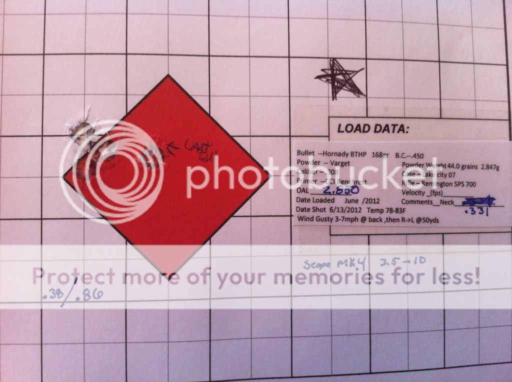

I also attached a target from previous day of (same Load) 44.0 grains #14, this was with a tighter neck that my current dies can not duplicate.
