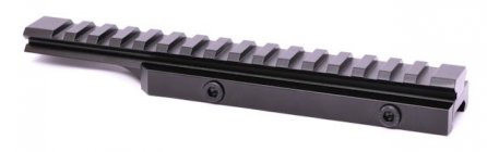

Back in 2016, when CMP Service Rifle rules allowed optics for the first time, what I did was get a Picatinny riser from ebay which was cheap but sturdy (like pictured below). I used some old rings I had and an old, made in Japan fixed 4X scope with a 34mm objective and a simple fine crosshair. This setup worked very well especially for EIC matches at 200 yards. The only reason I moved away from it was it was not good for dialing up for 300 and 600 yard across-the-course matches.
Those made in Japan scopes were sold in the 70's and 80's under different brand names and even unbranded. They're actually pretty good scopes and can be found used for around 50 bucks. Check ebay (and hope the one you get is not too beat up, pictures sometimes deceive!) and some inexpensive but sturdy rings and you can have a nice setup for...a hundred bucks? I bet this would suit your needs quite well. cheapriser.jpg
if you go that route, get the riser that looks like the one pictured above. There are some cantilevered risers on e-bay which are really cheap and flexy, springy. The one pictured is plenty rigid.
edit; ah, I don't remember if the front sight housing was visible or obstructing with that set up. At some point I replaced the front sight with a railed gas block (no sight tower) and that may have been why.
