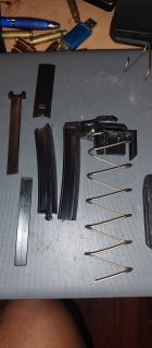

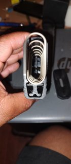

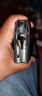

So the magazine is a lil tricky. I'm going with KAK's recommendation of using an 9mm Endo mag. Which is a cool lil deal where you basically just swap the guts out of a regular pmag with the Endo mag guts and boom you can shoot 9mm out of a regular lower If you where using a full size 30rd mag it's honestly like a 2min job , not even joking...but I hate 30rd mags on most of my stuff so going with a 10rd mag had to modify it a lil. Which now that I know how to do this....I'd say 5min ?

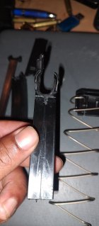

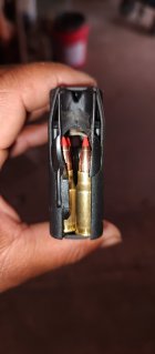

So legit all thou doing is cutting the place but down to fit the mag ( minute with a hack saw) cut the spring down and slip the 9mm rear follower out. Easy easy.
Now deal is , this I Perfect for factory ammo but if you like me and wanna do some cool stuff... Needed a lil more modification to make it so you can load out longer COAL / longer bullets . Still honestly not super hard..just cut the front follower out and use a Dremel to re do the ramp a bit...another 2-3 min no that I know what to do
IMG_20240819_214152746.jpgIMG_20240819_214203858.jpgIMG_20240819_214238267.jpgIMG_20240819_171833359.jpg
Now it feeds the longer dummies perfect but the shorter ones , you need to push the forward or you have feeding issues....which honestly all you need to do tap the mag against you hand after you load the mag and it moved them all forward.

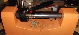

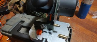

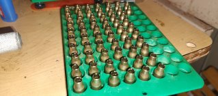

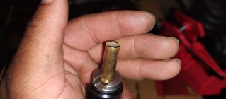

So you can also make your own brass for this lil guy out of 5.56, pretty similar to .300blk..a lil tedious but I was fun. And I have BUCKETS of 5.56/.223. so just used a little jig I bought and a mini cut off saw to cut my cases down

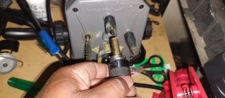

Quick annel with the help of a shallow 10mm and a bolt
Chamfer and debur before goin in my die
Then lube and let if flush off a bit
IMG_20240819_031557027.jpgone step reforming
Good vs what happens if you don't anneal
And trim, actually hand to pull this outta storage because of how small the cases are along with re doing one of the pilots since I can't find a .22 cal one

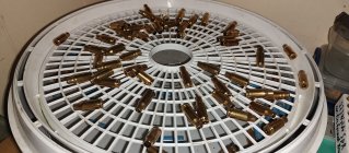

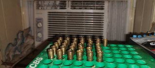

And another trim and de burr...a long with cutting out all the primer pockets :rolleyes: then wet tumble and drying

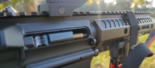

Now as far as shooting.... Had a bug or two to work out. Main was this barrel really needed a chamber polish , which honestly isn't difficult. 30cal brush with a patch some JB bore paste on the end of a short cleaning rod and a drill, no more stuck cases and like 10min.. fell like it should be done from the factory like that but haaayyy you sell me a $110 barrel I'm just expecting to do a lil work to it. Other then that and working out some stuff with the mag

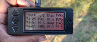

Factory Ammo and this lil 8" barrel is right here with the fastest .22 mag in a full size rifle so I'm BEYOND excited to try hand loading.

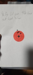

Well anyhow I got some 40gr vamxs to load up, figured now that I added a lighter trigger and the new scope is coming in soon I'll be able to actually shoot some serious groups vs just function testing like i did today lol

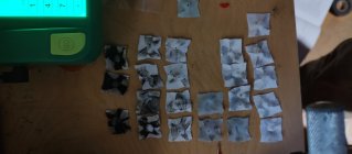

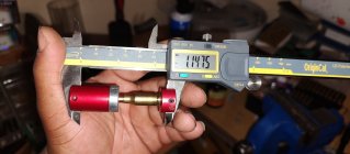

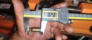

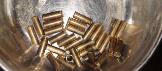

Now something odd I'm seeing while going though the brass is a bit of inconsistent fire forming not sure what's going on here
And shoulder measurements from left to right

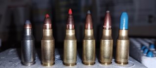

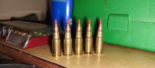

Also made some dummies . This is a 1:7 twist so I actually have a possibility for alot to play with.
To 40gr factory 35gr vmax 50gr vamx 45gr hornet SP 55gr sp 63gr Cast HP

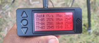

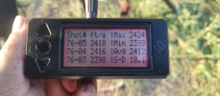

Gave her a once over today. It's had like 25 Rd of factory though it .Three patches of JB bore paste short stroke , dry patch it till it's fairly clean then two of solvent , dry patch it out then some rubbing alcohol. Honestly it's about what I expected for something using pistol powder

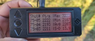

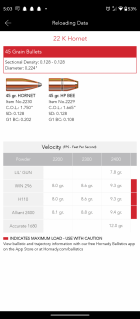

There's actually not a lot of data on this lil guy but common consensus is to use .22 hornet data. And since this is a bottle neck I thought .22 k hornet would be a little more appropriate.

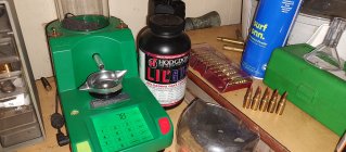

Was either h110 or lil gun and from my experience with the hornet lil gun is a lot cleaner. And more consistent so gonna try a base chare of 7.8gr
And these lil guy are just adorable loaded with these 45gr Vmaxes

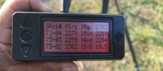

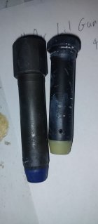

So now all I can think is the buffer spring and weight are just plain too much for this combo. So went inside replaced the .308 KAK spring ( what the reccomended )with the mil spec one but kept in their heavy 9mm weight ,
Loaded up five more but at 10gr just in case something squirrely might happen and shot it again . This time I got pretty decent function 3 outta five ..buuuut getting a different fire form. The right one is what I've been getting with the heavy buffer and the left is what this round got... So not sure if this is how it should be or ?

Actually got it running really nice with factory ammo after polishing the chamber a little but hand loads....well they have been a little bit of a pain lol

Well the problem was legit non of the factory ammo would even cycle before I polished the chamber , it just kept getting stuck. Not like now where it just won't cycle I legit had to mortar the charging handle to get the round out and even had a few rims break.

Being blowback I bet your bolt is moving or isn't completely closed that's why your case looks like that. If you go down in buffer weight and spring it could be worse possibly out of battery....just a thought
