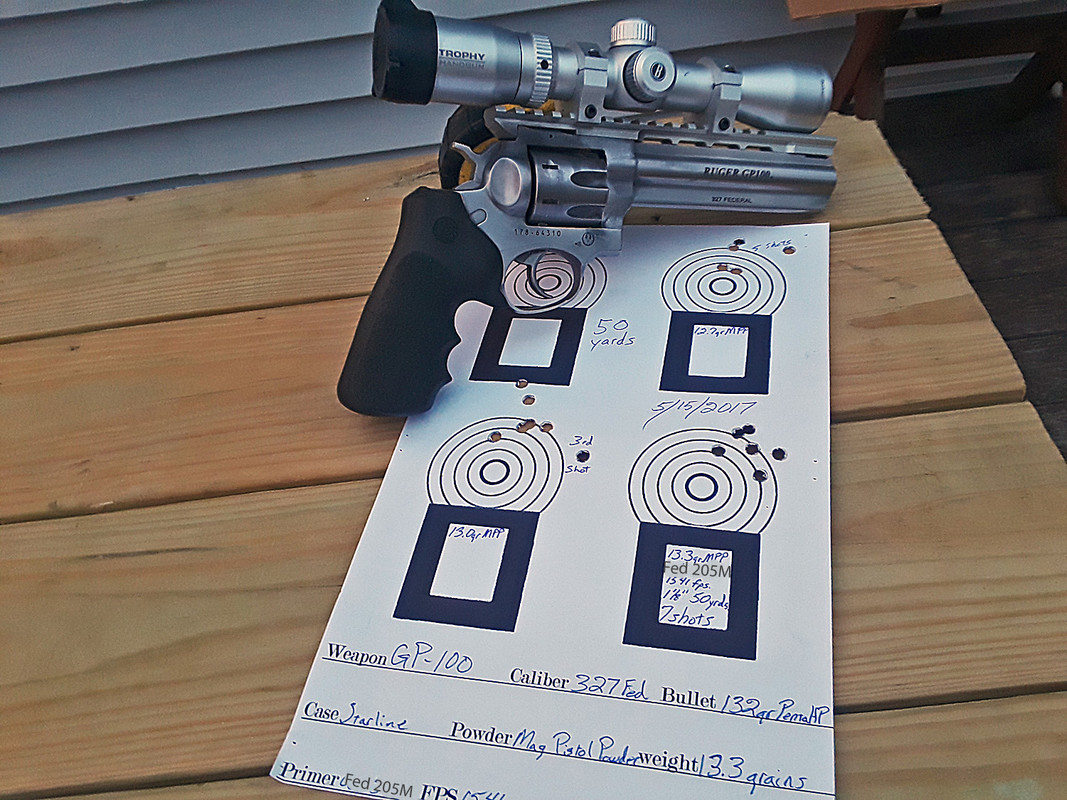

Even a little old 32 pushed to over 1400 fps, again with a heavy bullet you can't find in a jacket, and the lighter ones cant be pushed faster! Even though this gun had one chamber that shot different than the other six, it wasn't the bullet as this 50 yard target shows, over 1500 fps with a 132 grain Penta HP for varmint.
I proved that the bullets were not the flyer, twice the same chamber at 100 yards proved it was not the same as the other 6 chambers. But that 132 grain sledgehammer with that HP was the best varmint bullet I could find for out to 100 yards to 150 in this little revolver. The bitch was, I was stuck with a 6 shot revolver,,,

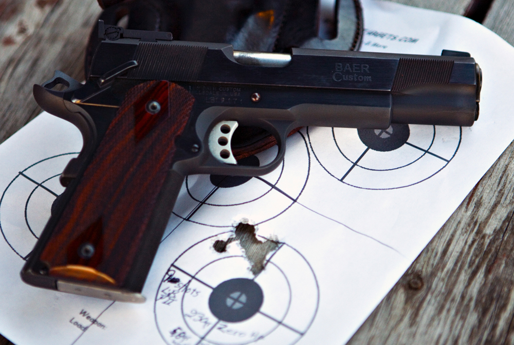

Even in my 45 acp these 200 grains are loaded to top book loads with ww-231
After shooting handguns longer than rifles, a Ruger single six was the first firearm I ever bought. I bought that new at our local hardware (the good old days) but have learned when you give your ammo the same amount amount of prep, and attention you give your match ammo for your rifle, in a revolver or pistol, even a rifle operating less than 2100 fps, lead is as accurate as jackets. In most handguns more accurate, and it takes less pressure to get the same speed as a jacketed bullet the same weight, and once you get that down, and start understanding alloys, even my HP lead are my go to for hunting medium game. Anything bigger than a whitetail, the 340 will take down anything on this continent.
I also shoot nothing but lead in anything under 2100 fps because I'm lazy! Jackets will fowl your barrel with copper, that will eventually ruin your accuracy. Every one of those handguns had over 1000 rounds though them in those pictures with no more cleaning than the outside and the on the revolvers the cylinders every few hundred rounds. The barrels never get touched! The don't foul, they season! That 45 colt has over 5000 rounds though it, and that barrel shoots better than day one, and never been cleaned!
