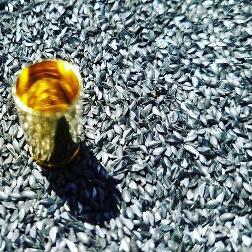

My son got started with pins. I followed up, and modified the process. We are both very picky , about the brass and how it gets treated, absolutely no range brass. His brass Lapua 338 , mine 6 ARC, Hornady, changing over to Starline 6.5 Grendel. The bigger the case, the more chance of escaping pins.
Cases are deprimed, dawn, lemi shine, stainless pins hot tap water, timer set for 30 minutes. Do not need anymore than that. Throw everything into Dillon tumbler ,rotate underwater,. Empty into another pan, coldwater rinse. Now pay attention. "" When removing cases from cold water rinse, shake the case sideways under water, the movement of the water will dislodge any errant pin that maybe playing hide and seek"" just like a riptide pulls swimmers out to sea. All cases go into aluminum pans , quick towel dry , summer months outside for solar dry, winter months ,short time in oven low temp. for final dry.
Before priming Always, Always, Always inspect interior of case for. FOD.
Have never found a runaway stainless pin. Inside a case or primer pocket, even large rifle .

I was cleaning .223 brass in my stainless pin tumbler and discovered this situation…….
while placing the brass mouth down in my loading block something caught my eye in one of the flash holes…… it was a stainless pin inside the case stuck width wise across the flash hole, I thought maybe it was a one off situation but I checked the other 49 pieces and found 5 more, which got me thinking about the thousands of rounds of 223 I’ve cleaned and loaded and the occasional unexplained flyers I’ve had, what happens to that pin when I pull the trigger, the primer can’t be hot enough to melt stainless but can the ignition of the powder charge melt it, if not it’s going down the barrel, will it damage the bore????
