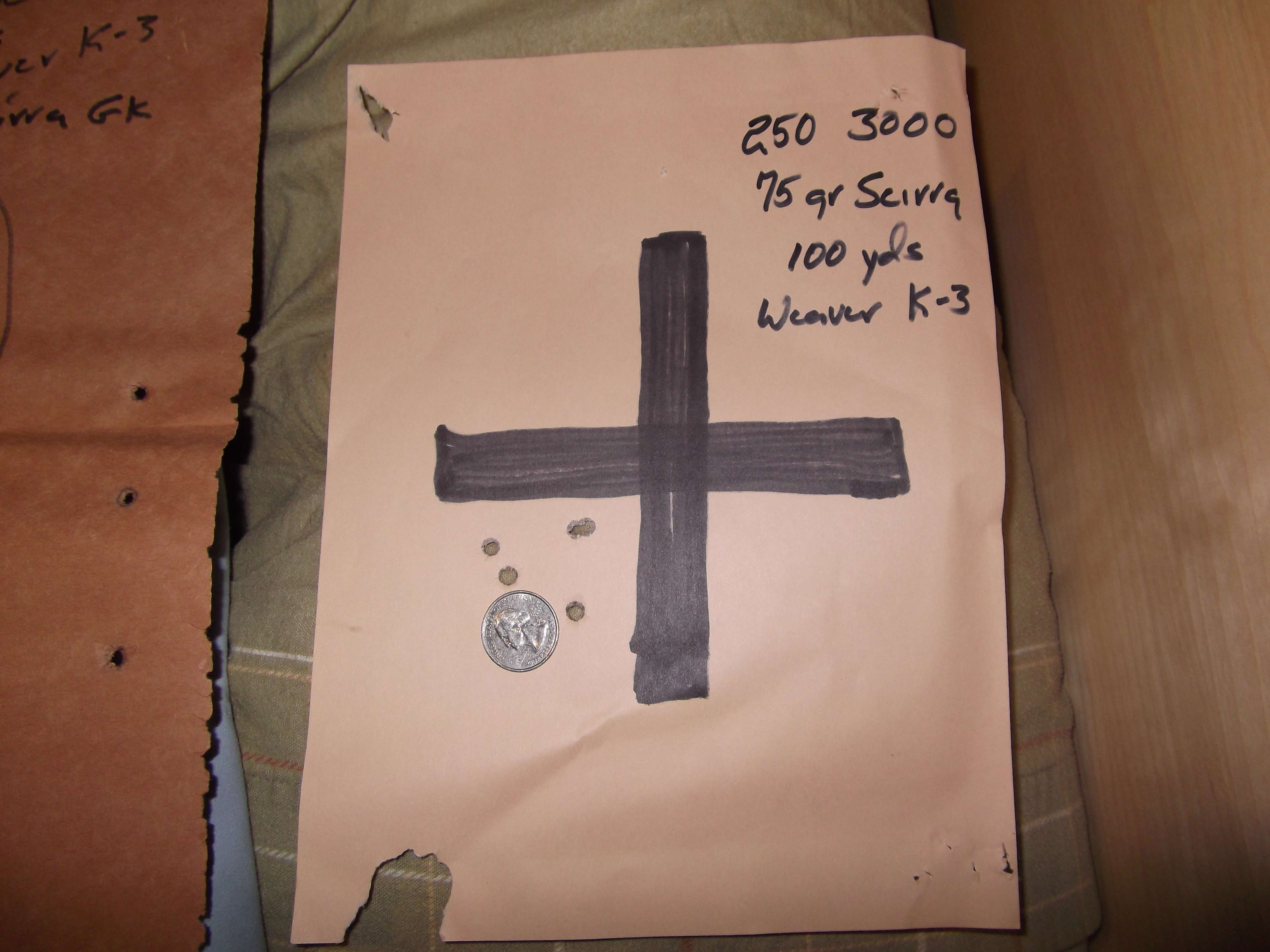

Well...here's something completely different. My good pal Randy Robinett has been on the lookout for a decent shooter grade Savage 99 in 250 Savage for quite a while. He recently snagged one complete with a period correct Weaver steel tube K6 and started right in on shooting it. Long story short, he got the thing shooting honest 3 shot groups under the magical 1" mark...a heck of an accomplishment for a gun like this with a two piece stock. In our conversations, we started talking about how these guns tend to crack the butt stocks behind the rear tang since that and the lower receiver cut are what the factory uses as the recoil bearing surface. The stock on this gun was perfect in those areas, giving more creedence to the fact that it hadn't been shot much. One thing led to another and pretty soon we decided to see how much, if any, tweaking the 'bedding' could help. Looking back, I think R.G. sucked me into this project because he knows I'm a sucker for any orphan gun and "That will never work!" type of stuff...Randy coined that phrase, by the way! ;)

Since AL pillar bedded the Sav 99CD/250 Savage, I've been shooting (usually) 3-shot groups at 100yd. with various powders, and 88Gr. FB bullets (made in a Clarence Detsch carbide die) at a full jam-seat, scanning for THE powder(s) worthy of snooping into specific charge-weight and seating-depth. All shooting, thus far, using the Weaver K6 which came with the rifle: @ 100 Yd., parallax is almost a full ring - I may, temporarily put a parallax adjustable scope of it . . . yep, I'm anal.
The bedding completely resolved the WILD first-shot fliers - those,usually were 2-3" high/right, between 1:00 & 3:00 O'clock. Via initial testing, with the same ammo parameters which threw the first shot, nothing has shot over 1.6" groups size, and most are 1" to 1.25". THE issue now, is taming the horrific trigger.:eek:
I have been able to shoot a group, sometimes 2 groups a day, or, every other day, as "things are upside-down" here, and time is at a premium - much of that due to my recent absence . . .
This project has been a re-learning experience - I had forgotten about case growth . . . and a few other undesirable "factory ("SAAMI spec) AMMO/chamber attributes.:D That said, thus far, the powder showing the most potential has been CFE223 (naturally, I have but a single pound of the stuff :p). I shot a 4-shot group, in which one "bad" case was included - just to see how far out it would go . . .
The group is just under 1.0" - way better than I expected a lever-action would produce - the two #1's is "old age" creeping up on me.:oops: The actual first shot is the low/left #1 - oh, NO wind flags could 'splain' some of the windage.;)
The target is a cut-out, of an "official" NBRSA 300Yd. score (Hunter/VfS) deal - the ring spacing is 3/4" - the [CFE223] hold was dead-center. Interestingly, & unexpectedly, all of the other powders grouped right around the ten-ring, with slight vertical variation, while IMR 8208XBR (the shot way down "in the red" - hold on red cross - the other three completely off the paper, and a 1.6" group) and the CFE223 both affected a pretty large POI shift. If this proves repeatable, it'll be more than useful for hunting - perhaps, BenchMark, H-322, or, the "ol reliable Brigadier 3032 will prove "magic".:) RG
Here's how IMR 4166 fared - not too shabby. The top right is 6-shots: two 3-shot groups, a day apart, with dead-center hold. The X-dot is 3/16th", and the ten-ring 1.5". At bottom, going up to 37.0Gr./4166, went vertical. IMG_0969.jpeg
