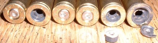

Pierced primers on factory ammo??!?!
So I went to work up a new load when I changed over guns the other day,
I changed scope between guns too so I had to dial gun in close again before I could work up an accuracy load. I had 6 Hornady 60gn TAP bullets left (223)
That I thought I’d use to get it close on paper before I started working the load up. I punctured 4 of the 6 primers!. I had to work load up anyway as I needed gun for work that night and barrel is shot on other gun. Worked up a hot but accurate fireforming load of federal primers 27.4gn ADI 8208 with 52gn Speer HP halfway up neck and no pressure signs or blown primer. Have had 300+ rounds through since and not a problem….. any thoughts?? How can a factory round do that?
The factory primers may have a thinner and/or softer cup. Are they nickel plated! As mentioned, check fp protrusion. Is your freebore really short? Its not likely with factory rounds but if they are jammed that could be it too.
99% likely that it's firing pin to bolt-face pin aperture fit. A slack fit allows primer extrusion around the pin that starts the 'blanking' process. (What happens to create the hole in the primer cup is actually pretty complex - I read an exposition on this in Precision Shooting magazine 20 plus years ago and IIRC was so long and involved so many diagrams it was spread over two or more issues.)
Answers? The hardest / thickest SR primers available, reduced loads / pressures, and the best solution in technical terms by far, elimination of the poor pin fit by having the pin turned down and a bushing with close-fitting hole installed. Gre-Tan Engineering must have altered thousands of mostly factory rifle bolts over the years. In the days of Remington 700 actions being used for most custom builds for 6BR and its variants, this was usually advised as a near essential job and should be priced into the build costs if at all heavy loads were contemplated.
How old is the ammo in question. I have had blown primers on older factory loads that have gotten wet several years prior. There was very faint corrosion between the bullet and case neck. You really had to look to see it.
Thanks all for the information and tips I’m not sure I made it clear that it’s factory 223 rounds being fired in a 223 AI, howa action and bolt with trigger done and safety removal with a 3rd 26” SS lapped and run in barrel around 5-800 rounds. I still can’t wrap my head around 1. It’s factory 223 made rounds being fired in a 223 AI, so pressure less due to fireforming brass regardless of how hot load is it’s still only made for 223 not 223 AI?. 2 if firing pin depth is wrong why am I puncturing factory ammo and not the hand loads even though at 27.4gns 8202 is hot as for a fire forming 223 round? Ammo is 12 months old stored in safe entire time no moisture, barrel not wet. My entire chain of thought comes back too.. if I bought those bullets off the shelf and jammed them in my 223 is it wasn’t AI’d what would
Have happened then??
The factory ammo should have a crush fit when closing the bolt? I think.
The piereced primers are from excessive head space?
But primers are crimped in?
Hope someone has the answer, i dont.
Brass "too short" for THAT chamber. (headspace) Round fires, primer tries to back out of the pocket, gets pushed back into the pocket and also gets pierced.
Pass on the firing pin bush thing. Throwing $$$ at it won't fix it!!
Once those rounds that got pierced are neck sized and the shoulders NOT pushed back too far, no more issues. DON'T SWEAT THE SMALL STUFF. Keep it simple.
Had the same problem with the 53gr factory vmax varmint loads in a factory Rem model 7. I think it's a factory thing on some of the loadings. .223 rounds and chamber.
I think @Laurie has it about right. My .223 RPR was an absolute bugger for piercing primers until I had the firing pin hole bushed since which time everything is golden. I can tell when my pal has shot my ammo -- his RPR has a new Keystone 26" bull barrel -- because his are the pierced primers :)
My .223 Savage F/TR rifle has a -- hmmm -- generously sized firing pin hole too which doesn't pierce, but can crater some. Using CCI #41 primers -- which are out there right now (Brunos) doesn't seem to hurt accuracy but corrals the cratering nicely.
