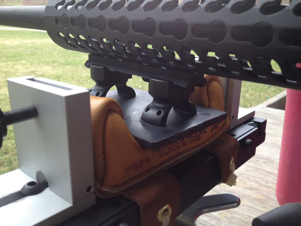

Where would one look to get one of these that mounts to the front swivel stud for a Savage 12bvss stock? Thinking it might be easy enough to make or machine one and screw right to the stock!
I made this one out of an old set of weaver style rings and a piece of
3" x 4" x 1/8" aluminum plate. It took less than 30 minutes to put it together.
