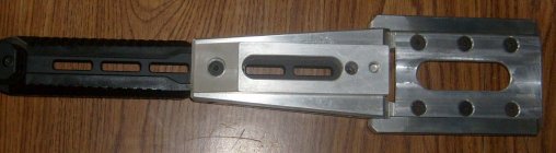

I'll see if I can get a few pics later today. I removed the rear plastic and
carved out a a new one piece bag rider butt for it. It's a pretty simple
straight spine. What's nice is the stock is machined from one solid piece.
I don't think front pics will justify what you want to see, and I just don't want
to take mine back apart. There is quite a bit of machining done to the fore
end to fit the plastic up. I don't know if pics will do you any justice for what
you have in mind. I initially wanted to remove it but would have made my
work more complicated, so I built directly over and thru it. In the mean time,
This is the raw machined butt I did as a prototype. 2 screws removes it in
under a minute.

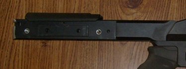

Pic of the rear spine, and bottom of the fore end . The spine, I cut
off about one inch to fit my project better and shorten the pull
length. The bottom has been cut away some by MDT to fit up
their plastic. I guess they wanted to fancy it up somewhat. I just
did my project over top of it all. Work in progress......
