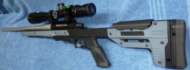

Just an update, I got my oryx chassis and I love it. No problem with the kelbly. Slipped right in. I planned on putting a different pistol grip on it, but the one that it comes with fits my hand perfectly. With a 24in bull barrel in it, it balances really well
Haven't shot it or cleaned it, but I'm very happy with the look and feel of it when I'm behind the rifle. Like it a lot better than my KRG bravo I had. It is a heavy sucker though, which I knew.
Thank you to everyone who chimed in. Much appreciated!
