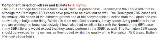

The issue described below may be the reason the 6BR brass is more popular.
This excerpt from the 30 BR section at the beginning of this website, is clearly dated material since it addresses the cartridge from a historic standpoint. This is definitely prior to Peterson, ADG and Alpha brass brass emerging onto the premium brass scene and specifically speaks to the Remington brass only.
