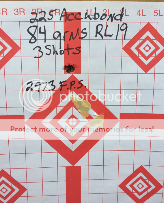

I chambered a #5 Brux for a good buddy and he hit paydirt. 100 yd target, took it to S. Dakota and killed a whitetail near 600 yds.
