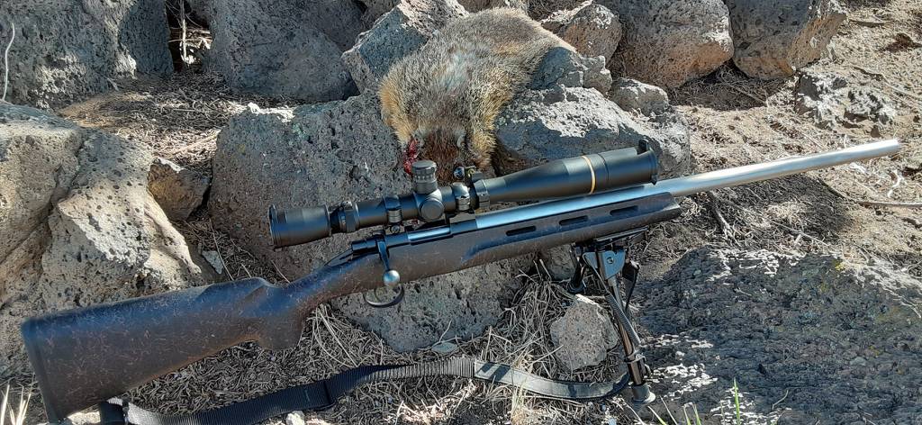

This is what I've settled on for rock chucks and work in the rat patch with my 221 "Furball".
I get the same results using RL-7, but I'm saving all of that I've got for my 20VT.
Great little underrated caliber. HTH
