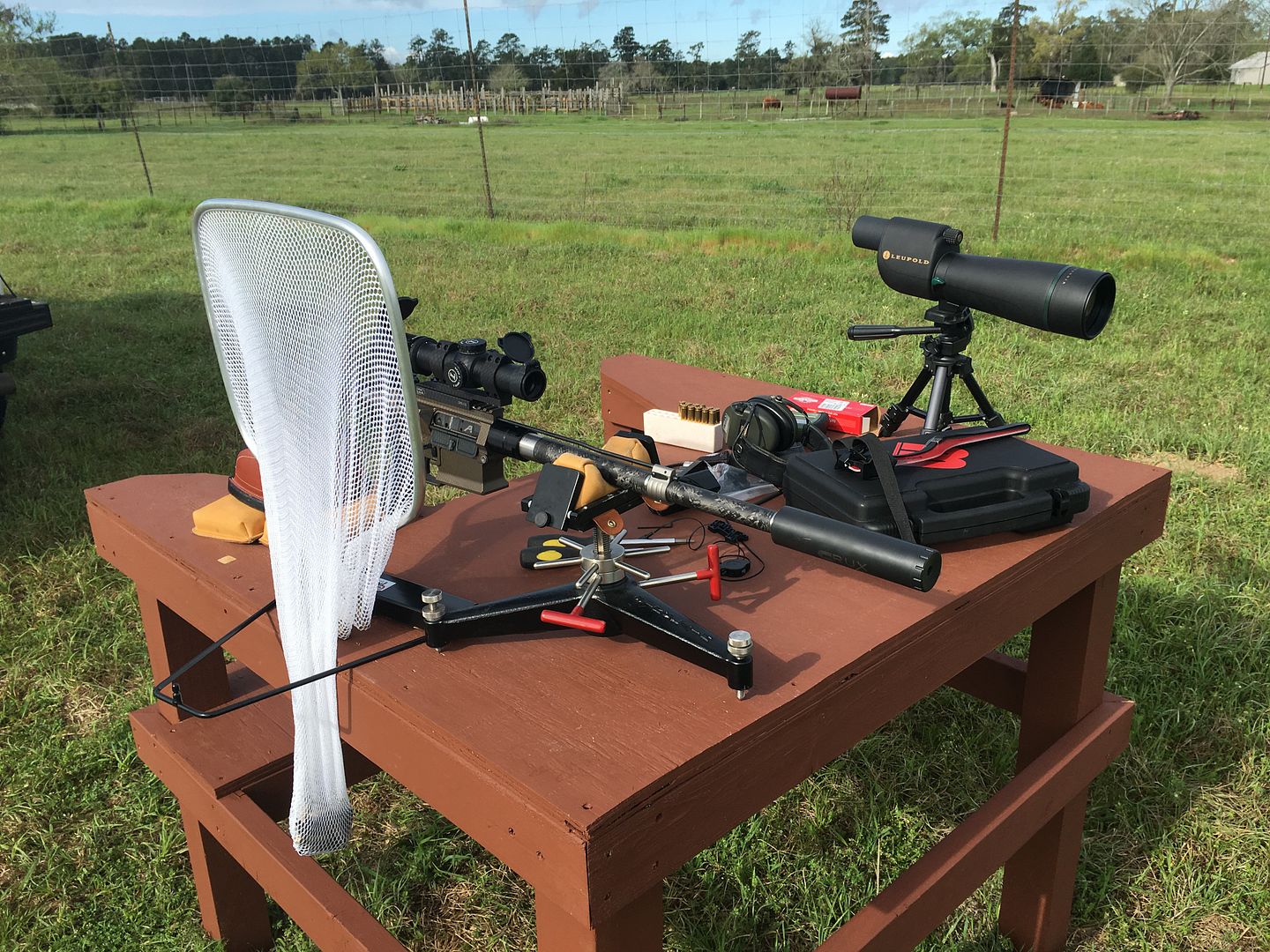

I have used this design for years. Has served me well.

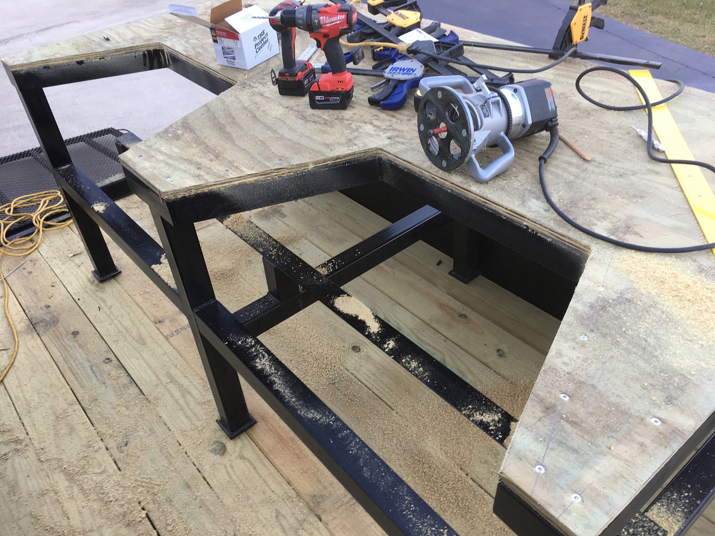

I even used an expanded version of it for a mobile shooting bench I built.
I like the stability of concrete tops I have shot from, if you can swing that. Otherwise, I doubled up on 5/8" treated plywood. Unlike the design above I made mine right handed only, which I regret, now that 10 years later I have a lefty daughter who is starting to shoot well.

Without a doubt you can. Honestly I used screws to assembly it and there is bracing under the table top. It's rock solid with just one layer of 5/8" plywood.
