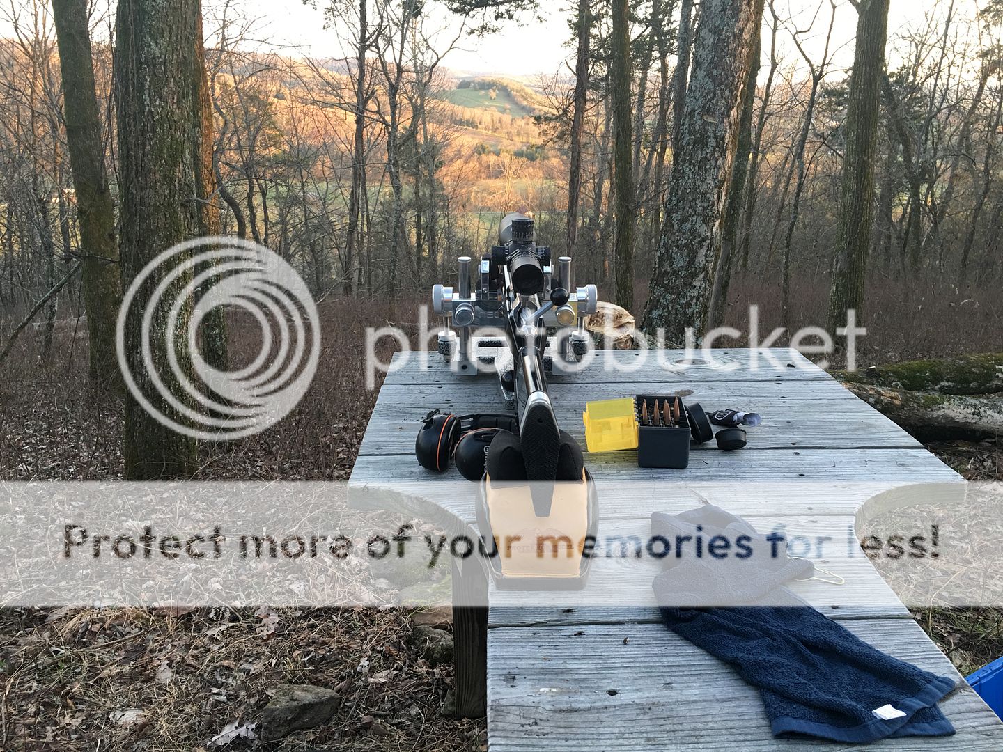

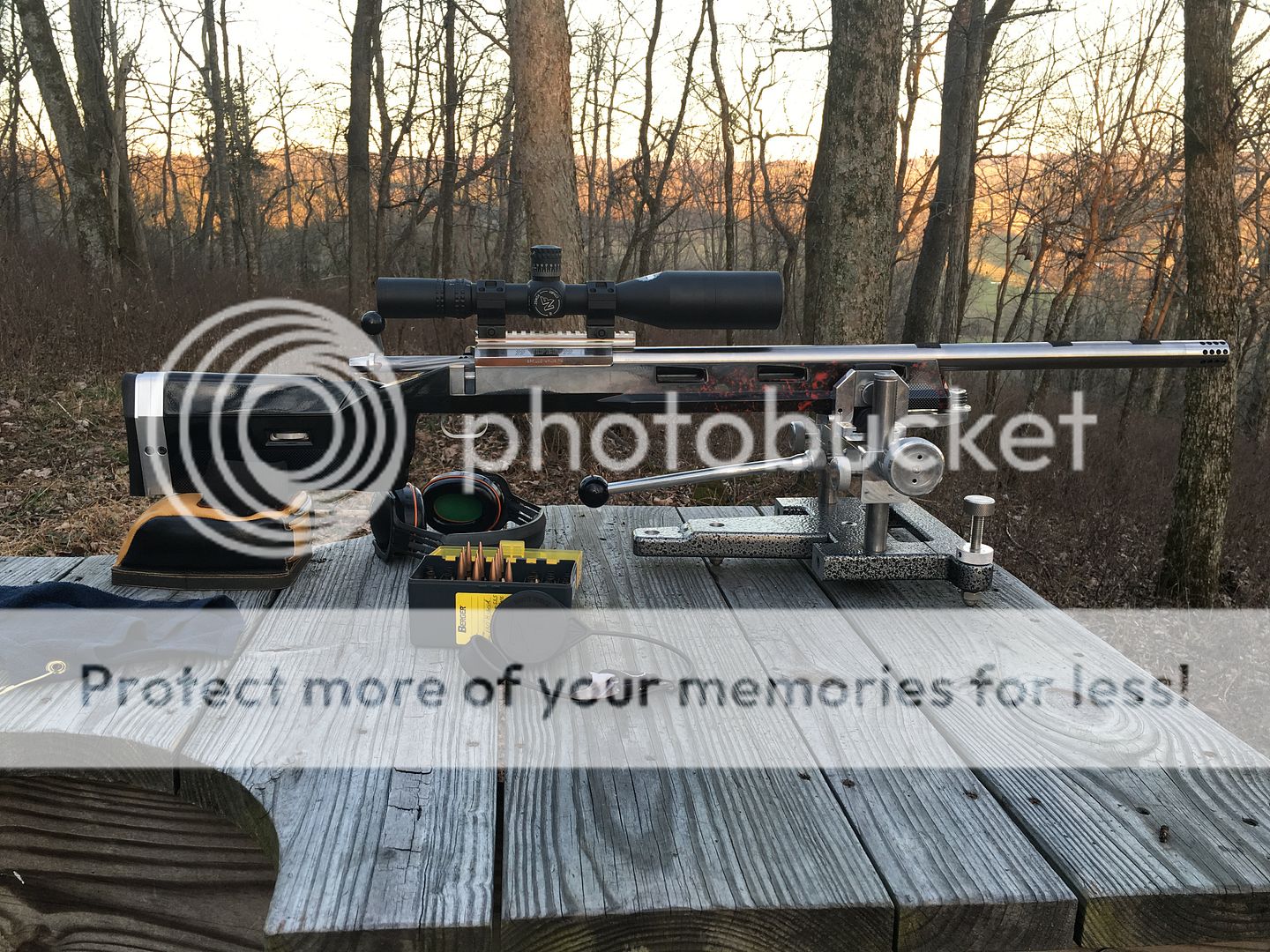

Action is a Viper SS (stainless) weighing 64 ounces.
Brux 1.250 No Taper, 9 twist, 28 inches
Robertson stock
Jewell BR trigger (Larry Scott, Great Scott Shooter Supply, Cadiz, Ky)
180 Hybrid
NF ACTAR MOAR T 5-25 X with 120 MOA
The action has a built in Davidson Rail so I installed a Stiller Picatinney conversion rail.
Switchbarrel---6.5 x 284
6 Dasher
Ranging done with a Terrapin.

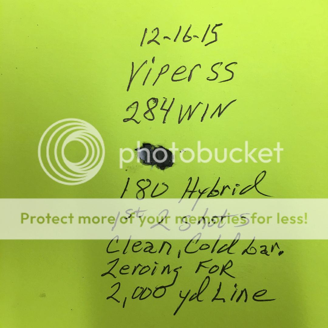

Checking zero for 2,000 yds with two shots on clean, cold, barrel

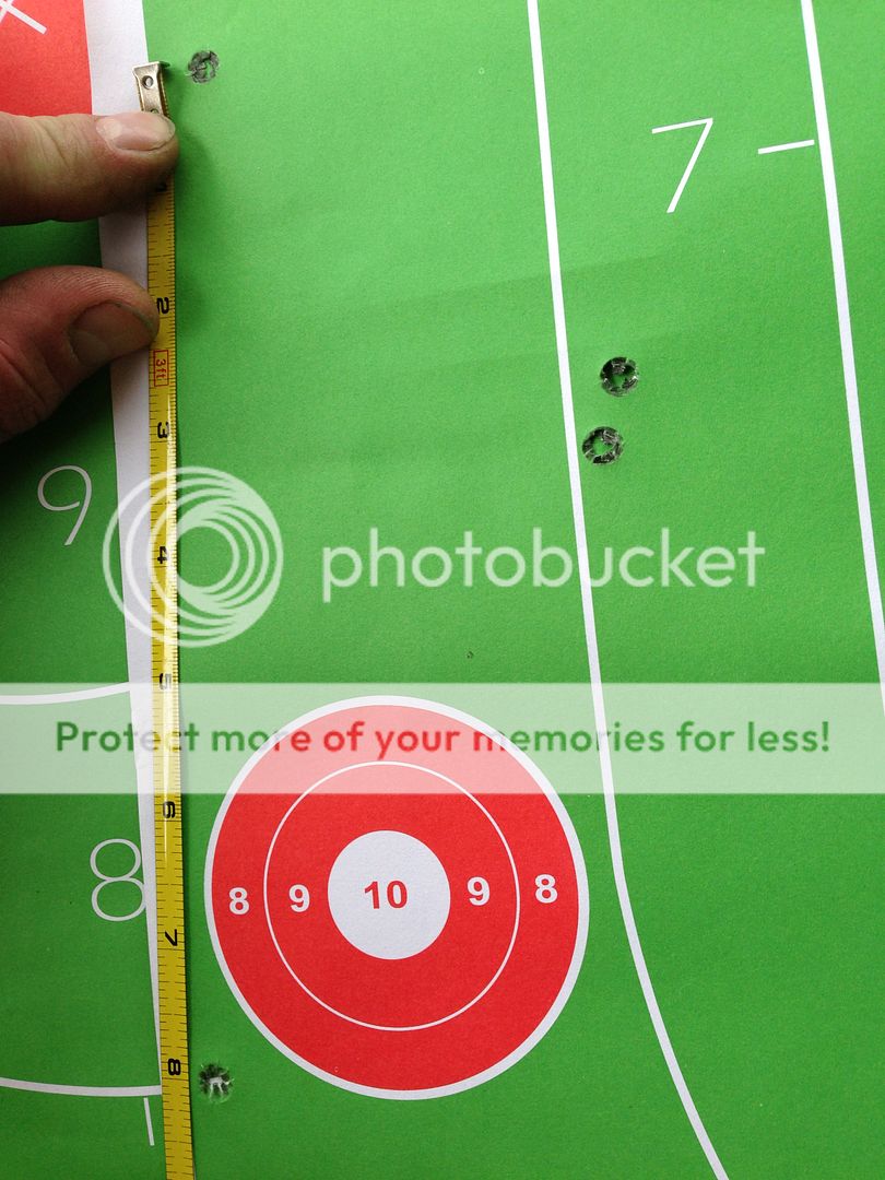

This was a paper target at 1500 yds.
Shooter Tracy Milsap
One sighter then 4 on paper
8 inches at 1500 yd
