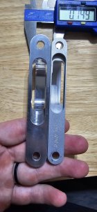

I'm having a hard time sourcing a trigger guard for a panda f-class action. My trigger guard stock inlet is .75" wide and the hole spacing appears to be 3.875".
Anyone know where I could find a trigger guard that size?
Alex Sitman at Masterclass stocks offers an awesome trigger guard for Panda F-Class actions that utilizes your rear and middle action screws, This allows you to remove your trigger hanger without taking the action out of the stock.
Most are 5/8 wide. Not sure you'll find one 3/4 wide. Never seen one anyway. Not a huge deal but a PITA to fill that little gap and touch up the stock but it can be done nicely. If painting, no big deal.
Thanks again! Just ordered on from Alex. Really slick design.
If anyone needs one of the oversized trigger hangers as G7BC described, give Alex Sitman at masterclass stocks a call. He was outstanding to speak with today.
.749 wide, little bit longer as well. This one is from another stock I have that is the same size inlet. I just never knew where this trigger guard came from but it is one of Alex's.
That's great to know about it. I wasn't aware of any that wide but they'd be a real problem solver on several that I see that have a really messed up trigger guard inletting job already done on them. I'll certainly keep this one in mind. Thank you!
