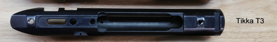

I have a tikka t3 that I am going to try and bed in about a week. It does have a flat bottom. Of course, not as wide as your BR type flat bottom actions. What is high spotting and how does one work to avoid it?

That Tikka isn't really considered a flat bottom action, at least not in the context Al was referring to. A Panda is a true flat bottom action. Being totally flat and 1.5" wide, the epoxy doesn't have a good route to flow out from underneath and can, as Al called it, high spot in the middle. Your Tikka is mostly round and you shouldn't have any problem with that. The biggest challenge with bedding a Tikka is in how you choose to deal with the recoil lug. One way is to just super glue it into the notch on the action and bed it as one piece. When you remove the action from the bedding, the lug will stay in the stock. You'll want to keep release agent off of the recoil lug by this method. This is one way but there are others. Maybe Al will offer some other advice in that regard.

I sure encourage you to use a sleeve around the action screws. On the 'Teekers' I've done, the ones I've pictured have worked fine with the metric action screws. Same for the Howa's. What are you using for bedding compound? -Al

For sure Al, I need to source some sleeves for my setup. I have some headless action screws on the way from Larry P. I will measure them once they arrive and see what size I need. I'm unable to turn my own pillars. Also not sure of what stock I can make them from other than threaded lamp rod. So I have some threaded lamp rod and some lumey arms made pillars specific to this Tikka action.
Once I get the action screws I will post here and show what I have and we can discuss what I should use for pillar hole size, pillar internal diameter and sleeve size. I probably could figure this part on my own, but I'm happy to document the process and discuss so people can have the info for the future.
