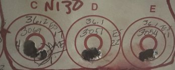

Wanted to finish up my powder testing with this barrel but the wind was crazy today -11 mph wnw with 26 mph gust. Didn’t really want to get a weather report but figured l would try to catch a condition and get 5 off as fast as I could.
Based on prior experience shooting N130, I knew I would have to be between 36 - 36.6 or so to get the velocity I was looking for.
I shot three five shot groups and did not hold for pickups or let offs.
In the first group, shooting 36.2grs., I got lazy with my gun handling and pulled one shot out of the group—trying to shoot too fast. The velocity was 3069, a little faster than I expected.
I had 10 prepped pieces of brass left, loaded them all at 36.1. and shot two more 5 shot groups. The groups looked almost identical and hovered around .2. Considering the conditions and me not holding for pickups or let offs, I was pleased with the results. Also, I did not tune for seating depth with N130. I seated where tune landed with H4198.
Long and short of it, I feel as comfortable shooting N130 as I do with the H4198.IMG_0821.jpeg
