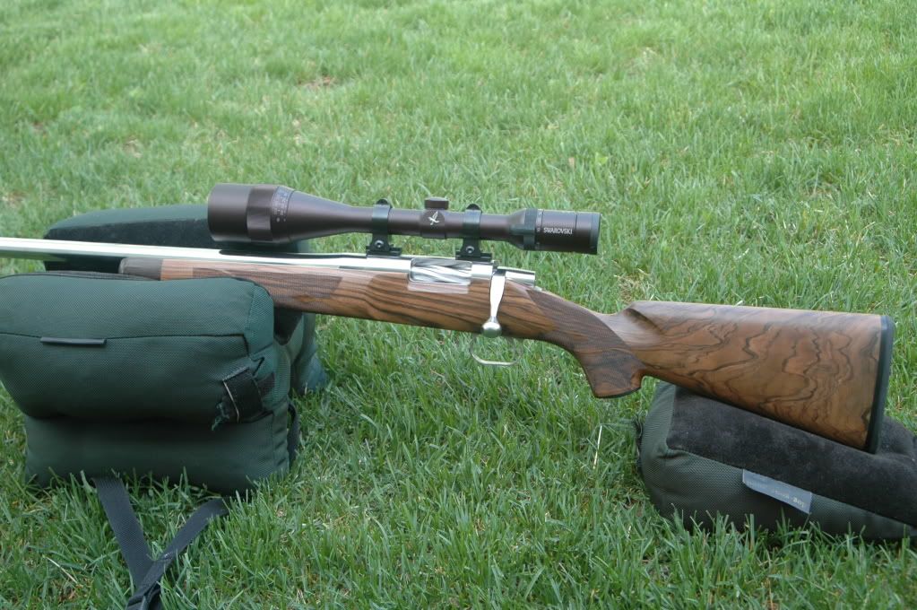

Hillbilly, I'm already looking forward to building my next Vartarg. This is close to what I'd like it to look like.

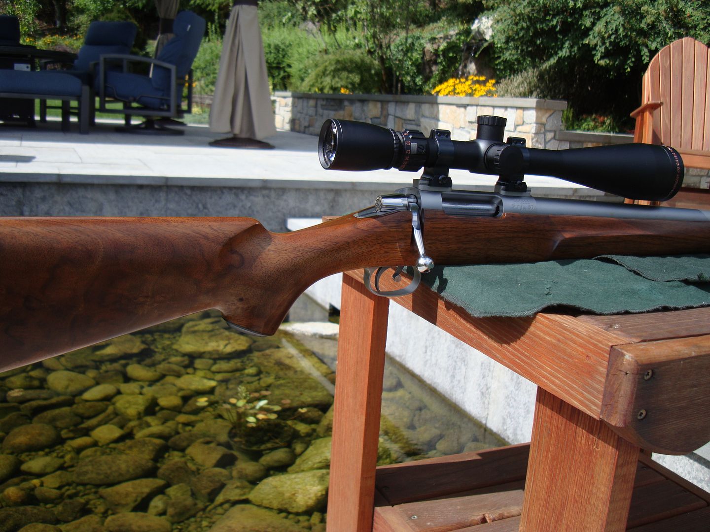

Here's my Dakota and the first 4 groups I shot out of it. The first group (largest one) was .368". The groups went counterclockwise from bottom left.
I have never built a 20 Vartarg on the CZ. I have built 222s and the like. Couple of my shooting buddies have CZ 20 Vartargs on CZ 527. They work great and the round feeds very well out of the mag. Thats some good shooting Dan. It doesn't surprise me anymore when shooters tell me they shoot 1/4 or less groups with the 20 Vartarg. Just a Wicked Little Awesome Cartridge! 222 Rem was my favorite until the Vartarg Bug got ahold of me. Right now with the Norma and Lapua Fireball brass we have it better than ever when it comes to loading precision ammo for the 20 Vartarg. I am running norma in my Mullerworks barrel and Lake City formed in my Lilja barrel. I have two hundred Lapua waiting to be loaded. 20 Vartargs want burn out like alot of others. They just aint hard on barrels.
