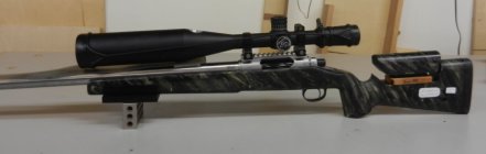

The first P Dog gun I built up has a McMillan HTG stock with a cheek riser. The second is a McMillan A5 with a cheek riser. Both of these are no longer made.
The next one I build will be a McMillan A6-7. It is similar to the A5 I have, but it has a wider, flatter fore end.
I have 3D printed a 3" wide fore end for each stock to ride in my front rest. The round bottomed fore ends tend to roll in the front bag, and are more difficult to maintain level.
I have a Seb Mini front rest, and a Protector Bag in the rear. I make big elevation changes by sliding the rear bag, so I need a stock with a slope on the rear. ( no, reaching forward to crank the mariner wheel to raise the front is difficult and disturbs the rifle). I have looked and never found the perfect stock, which is in my opinion, a A6-7 with a 3 or 4 inch wide flat fore end.
If you get a cheek riser, get the kind with two posts and a clamping knob in the center. You must take the riser off or lower it all the way to clean it, or to take out the bolt. Do Not get the screw adjustable riser, it is more difficult to take off.
Once I find the cheek height I need, I make a wood spacer to place between the riser and the stock so I always return to the same height.
Everything depends on the rests that you use and how you set up.
Here is a pic of my set up and A5 stock
