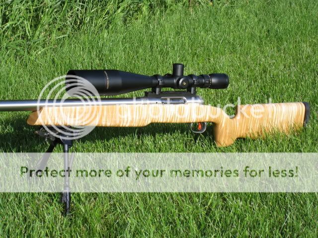

I built mine on a Savage RB/LP target action and 30", 8tw barrel. Recoil is not bad but I wouldn't mind trying a muzzle break. I shoot mine off a bi-pod but a portable table and bags would be better for 800-1000.
