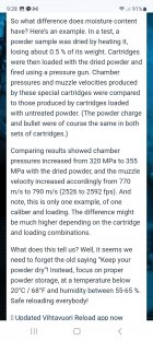

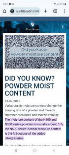

This is from the Hodgdon FAQ site, recommended to store at 50-65% RH, too dry can give more static electricity, single base is more hygroscopic (attracts water) whereas double base is more resistant (more plastic-like due to the added nitroglycerin).
I have all my "opened" powders stored in large sealed containers with Potassium Carbonate (K2CO3), the potassium carbonate maintains a humidity level of around 43-46% and the powder stays very consistent. To dry powder out just leave it in your dispenser for a week or 3, the dryer the powder the faster it burns.

This is a good read on the subject with some good testing that was done.
