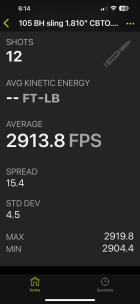

I had a jug of H4895 that was stored in a non climate controlled area. Was loading for new rifle in 6BRA and was about 100 fps under what others were seeing. FB moderator suggested drying the powder. So I put a pound on a pie plate in a food dehydrator at 105 F for four hours. Velocity came up and the SD was mid single digits with the dried powder.
Since this time I have routinely dried my H4895 and had very consistent results with less lot to lot variability.
Your mileage may vary. But it works for me. Just dried 2 pounds last night.
Here is a jump test I ran on a new barrel with 105’s with dried powder. Seating at the bench, I seated 12 at 1.810 and shot a blind group ( it was getting dark and I could not see holes lol) Called two shots left, one shot low right. Other 9 broke center. IMG_1004.jpeg
This 9 shot group shot from a sling went a hair under 0.5 moa with SD of 4.5 ES of 15.4
Ballistic-X-Export-2025-02-02 16:57:47.264674.jpg
Yeah - I’ll keep drying my powder for this rifle.
