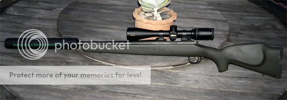

In the end I sold it and have stuck with several .223s including a suppressed semi-custom which is like a std HV rimfire to shoot except it hits like a .223 :D
