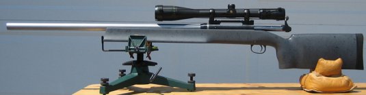

I agree with gunamonth, I did a very similar thing with a savage 12, took everything off, only the action remained and I had that trued. SSS trigger, Ken Farrel bases, SSS recoil lug, PacNor 1.055 straight barrel at 28",8" twist)Burris signature rings, and a stockade long range stock.
