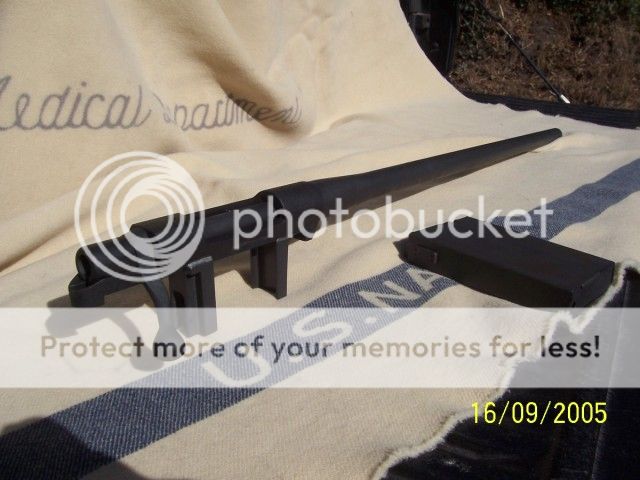

One could also use a 1"-16 standard tap to convert a Howa. I did one a while back and stuck a take-off Remington varmint barrel on it. Adapted it to take M14 mags also. Shot good.
thats pretty cool :) mag setup looks real nice.

My mom has that same blanket kendog,havent seen one in years.I love that conversion you did to take m14 mags,quite ingenious.
